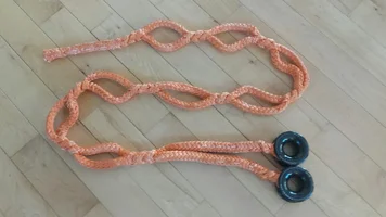

I'm pretty sure it's good to go Raj. Basically a loopie from what I can tell. but who knows?

I originally looked over the photo of the sling too quickly. That, followed by thinking about it without a clear understanding of the build has probably led me to the wrong conclusion. It is, in fact, just like a loopie and should be fine.
I think seeing the 2 handles gave me the idea that it had two adjusters in the same throat, but that makes no sense at all. Totally my bad here.
Understanding it now, I would say the only potential drawback would be that at some range of adjustment, the throat may not be centered as the bar of the girth hitch, which may or may not be an issue at all.
It also leads me to imagine another piece of kit... One loopie, free of hardware, and a L-Ring to L-Ring prusik added in, English style. Does that make sense? Since the loopie wouldn't be retrievable anyway, you can run the 2 L-rings, but be able to position them on the loopie for best location based on adjusted length.
Been using this for a while. Borrowed the sling idea from the ABR Ultra sling from TreeStuff.com (an excellent product), but used two independent lengths of cordage. My original was 5/8" Tenex Tec with two large rings. This one is 3/4" Tenex Tec with two "Beast" rings. At just over 10' overall it will work for stems up to 36" in diameter.
Thats friggin awesome!
BTW I use this for negative rigging, not as an overhead rigging point. I dumped some big loads into the 5/8" version (upwards of 1200 lbs) without any observable compromising of the sling.
