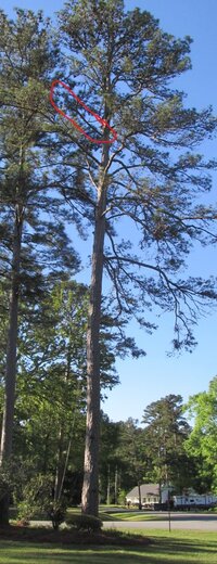

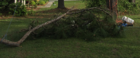

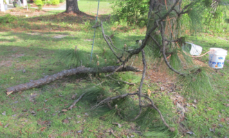

Busy day today started with removing a large unwanted limb from a pine. First drop was this side branch.
Then another climb to get the outer part down. I left a four foot section hanging to lower after I came down.

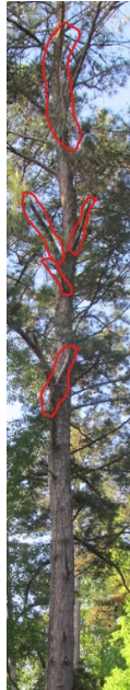

In the late afternoon I climbed this oak to remove all the unsightly suckers and a dead limb.
The TIP was good for going up one side, crossing over the large limb, and coming down the other side. Got them all in one climb. I sure was glad I took my water bottle up on the afternoon climb.
