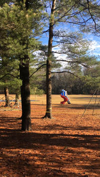

Took two visits for this leaning short leaf pine over a new ADU. Second visit destroyed my lanyard with sap.
Speedline then negative rigged logs until too lowView attachment 92858View attachment 92856View attachment 92857
I recall a while ago working in broken White Pines for 3 weeks. I wanted to burn all my gear when we finished, even after washing it in the hotel every night. Ugh. I can totally relate. Nice view, though, and speed linking is usually pretty satisfying. The negative rigging must have been fun that close to the ADU.

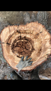

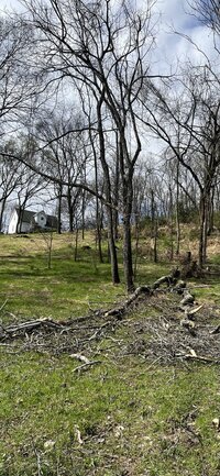

I had to untangle this mess today. The owner wanted to save all the other trees around these two. I climbed the RH tree and dropped 4 limbs (Topped it) to keep it from hanging. The LH was a tree of heaven at about 34 inches. They killed it last fall and I wasn’t keen on climbing to the top. When I got about 30 feet I decided I could drop it. I had a rope in another tree. Yes some risk but the owner was cool with collateral damage. Good 3 hr day.

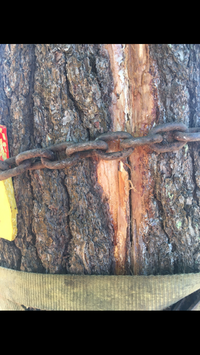

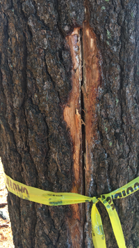

Felling a big fir on a dangerous slope close to a deck, chain for safety.

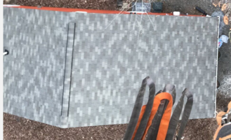

Todays job: removing a madrone way over the house with a hollow and failing base, along with the large fir with all limbs over the house. Ran up and stripped the big fir, lowering most limbs and the top given tight space and wind, used that stick as a high spar for my climb line and rigging, threw the Captain Hook into the madrone and shifted gears to that tree, swung that material out to the side of the house with a little haul-back line, then chunked out the fir. Not bad for two people in a day. No cleanup.

Good roofs are wonderful. This one was low slope, totally solid and has a tie-in point at the top edge (per building code) so you can move around the roof safely attached. For the lowest limbs (and some trunk wood) I passed material down to my ground guy who could then walk the brush to the edge and toss it off. I'd never do that on a two-story house without attachment points. We have a decent number of cedar shake roofs here which are similar to tile I imagine, fragile and can be VERY expensive to repair if you so much as drop a stub and crack one. I've turned jobs down due to fragile roofs underneath the trees before.
