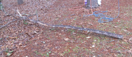

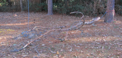

I started out Thursday morning by taking down this dead limb with a controlled speed line.
I had already removed part of it Wednesday afternoon.
I had originally planned to take the whole limb down at once, but I changed my mind after seeing how big it was up close, and deciding my speed line setup wasn't good enough for the whole thing.

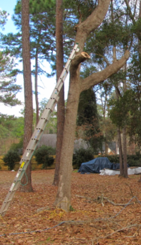

Working from a ladder isn't my favorite thing, but there was no suitable TIP that would put me where I needed to be. I did wear my harness and tie in with my lanyard, though. I had already climbed the tree at far right to remove the outer part of the limb in pieces and tie a rigging line to the limb so it could be lowered safely clear of targets.

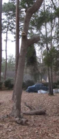

Did the same thing for this another limb, and ended up with this.
There's some good TIPS to deal with the remaining limbs so I can whittle it down before felling.
View attachment 85835View attachment 85838
The base of the tree is a mess (picture later), and the homeowner wants the tree gone.
Strapping the ladder to the tree if you have to work off one can be a good idea. Can't tell if it is or isn't just figure ill throw that out there
I run my lanyard through the ladder and around the limb it's was leaning on. I avoid leaning a ladder against the trunk. I'd rather just set up to climb.

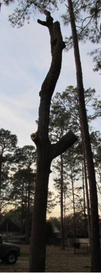

I was able to get the remaining limbs and top off today leaving me with this:

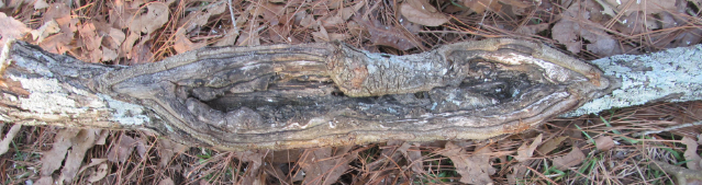

The vertical cut on the section I removed revealed this image of a dagger looming over a monster.
