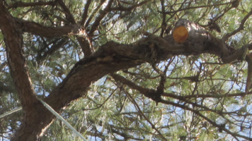

I used this setup
to remove this
before rigging the rest so I could cut it loose
and lower it after coming down.
Removing live limbs isn't my usual thing, but the owner can't afford a pro removal and asked me to remove as many as I felt comfortable taking down. I'll probably get a couple more low ones as well as some dead stuff higher up.
I was able to isolate a high TIP and a redirect after one good shot.
That let me get in position to cut all this stuff
that was hanging below the damaged and healed limb.
That took about 75% of the load off the healed area, so I felt comfortable leaving it there.

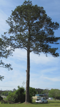

So I was out for another three week stretch due to back problems (why I haven't been posting much), but have a few days back in the saddle now. Then yesterday, my ground guy tweaked his back.... and after buying the Arial Friction Brake setup from @JeffGu a while back ( https://www.treebuzz.com/forum/threads/light-rigging-sold.47899/ ) I decided sure, today is the day I'll try it out, I'll do a canopy raise over a septic system on this big ass fir solo.....
I used slings from my MonkeyBeaver speedline kit, and by facing the limbs and hanging them into the hook, felt very confident in the safety of the system, but obviously you wouldn't want much swing or dynamic motion or it could come loose. Once on the ground, I had no trouble shaking the limb off the hook from in the tree.

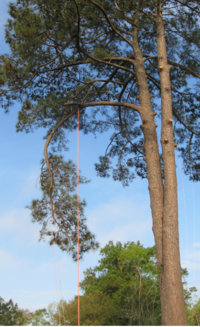

Big tree, big limbs. The device, is.... OK? Honestly it handled these huge limbs with total confidence which was great and all, let me do this solo which was neat. But you do have to fight the line back up even with 'one wrap' and working both legs of the rope, and that one wrap let me hold like 400 pounds of limbs at once with one hand. I didn't lower anything small or light, but I imagine that you'd be fighting it a bit to just get it to the ground. Just running it over the device gives hardly any friction, so you can hardly go lower than this setup. Using this with three wraps would be interesting, you'd need to be doing huge pieces. But in the right application, it would have a use.

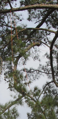

Multiple limbs at a time slung together. I also ended up bringing the rope bag and tail of the lowering rope up with me so it wasn't on the ground getting tangled. Made things a lot easier with bushy 25' long fir limbs, but I had to get all tangled up to learn that lesson, and I still had to go to the ground twice during the job to process material. So yah, got to ascend this three times today...

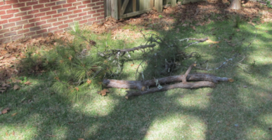

Pile o limbs on one of the trips down to process.

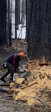

Yeah that’s it, and I cut the far side of the hinge off, we call it a swing cut but I’ve found that other people call these things different names . Like the sizwheel: we call it a draw notch. I never heard the term sizwheel until recently. Tree was leaning away from the camera hard and back to left. I was standing on little saplings and pieces of face cuts in the creek trying to keep my feet dry, kinda wobbly.
Always impressed with your technique man, good mix of work by the look of it too. Terminology can be wicked local, Sierras vs coastal Humboldt vs BC. I’m just sifting through in Maine behind a book and screen…
I like hotsaws101 older videos which have a couple “soft dutchman” examples, didn’t know if you’ve utilized? It accomplishes the same kind of turn to the lay but with a bunch of cripple kerfs in a Humboldt. Wish he had done some closer shots of it as the swing to lay without driving a wedge was impressive.
Sometimes it works good. Sometimes it doesn’t work at all.
Can’t trust it. Those Doug firs were holding on pretty good. Jack(hotsaws101) excellent timber faller for sure. I saw that soft Dutchman video, crazy.
