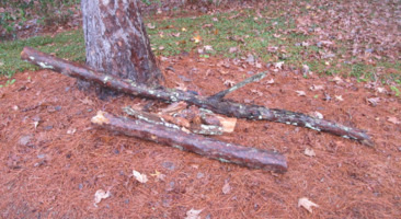

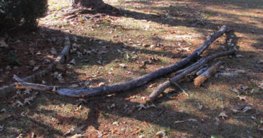

It brought down a dead limb I was planning to remove from the big tree to the left, but there's several more I'll climb to get tomorrow. I'll have to be extra careful with the one extending over the roof.
You can see the yellow throw line that's already set for the climb. I like to get that done a day early since I never know how long it's going to take to get it properly isolated on a good TIP.

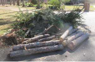

Here's what I brought down today. I used a controlled speed line on the long one that was over the roof.
They're all safely at the curb along with the pine tree I cut yesterday and bushes I trimmed last week.

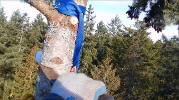

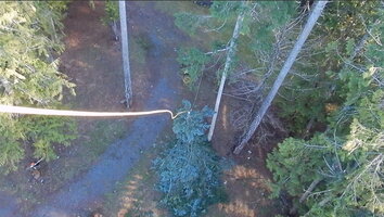

Speed-lining a doug fir over a house, the top in these photos. I may make a dedicated a thread about it at some point, but quickly I have to say the MonkeyBeaver speed-line slings and magazines really are excellent and well worth the money.
Edit: I probably don't need to say this, but for the record: when speed-lining a top; keep it a safe size/weight, always use TWO slings choked on opposite sides of the trunk, and carabiners in opposite orientation.
