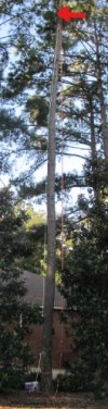

What a nice day. I started early with a 45-minute 105 steps/minute walk followed with setting a line for an upcoming dead limb removal. After that, I arranged and gave estimates (my favorite part... "Seriously, I don't charge anything.") on three new projects.
One is for removing two hanging dead limbs, one above the other in a big pine tree. The second is for two largish attached dead limbs in a big pine.
The third project was for removing two dead trees and pulling down some low dead limbs. Since it was mostly in a shady area with no climbing involved, I decided to do it this afternoon. The dogwood was severely rotted, and broke up as it fell. The pine was larger, and it fell just where I wanted it to with a little encouragement after getting hung up in nearby trees. The second picture shows all the debris from the afternoon's labor.
