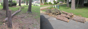

The third project was for removing two dead trees and pulling down some low dead limbs. Since it was mostly in a shady area with no climbing involved, I decided to do it this afternoon. The dogwood was severely rotted, and broke up as it fell. The pine was larger, and it fell just where I wanted it to with a little encouragement after getting hung up in nearby trees. The second picture shows all the debris from the afternoon's labor.
