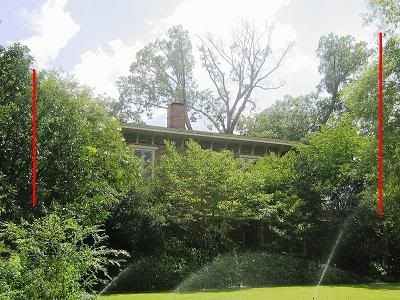

Red lines mark the width of the tree.

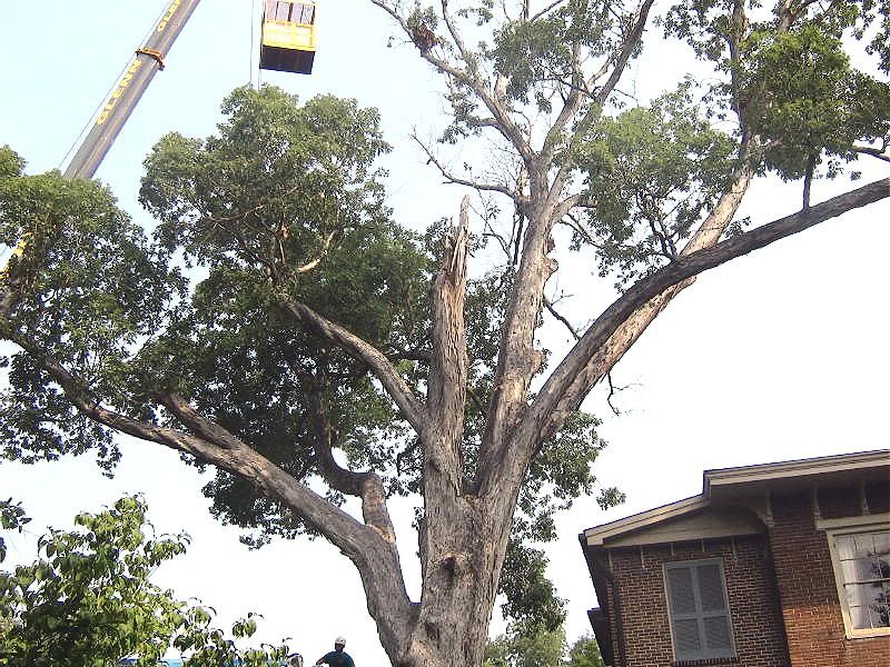

Lightning struck the top, killing it, although the rest of the tree is doing fairly well. I havent counted the rings yet, but they say its 300 years old (it was approx 175 years old). Can't ride the ball so I have to use the huge and somehow "safer" man basket to set the slings:
Getting the rigging set for taking the top out in pieces.

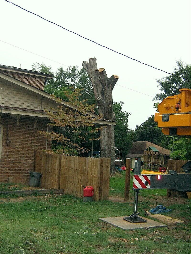

40k lbs of wood left standing
The lower cut of the the snap cut is about 12' from the stump cut.

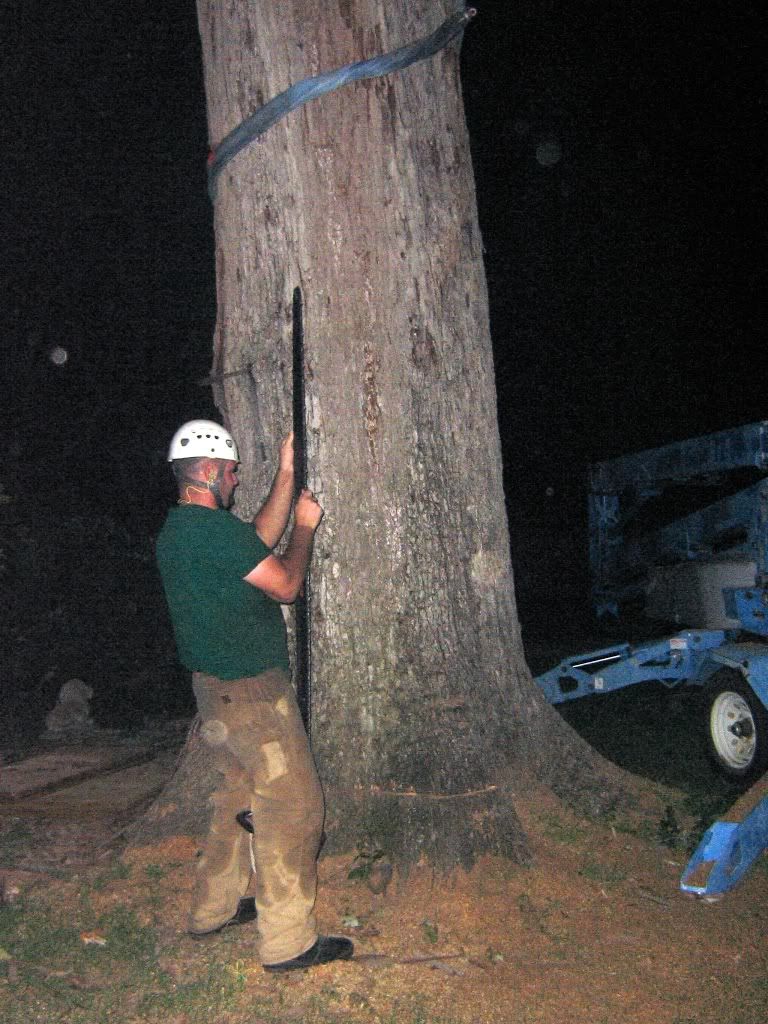

Fixing the chain, ordered a 72" bar for an 088 for this tree. The customer wants a slab of the trunk, he bought me the bar.

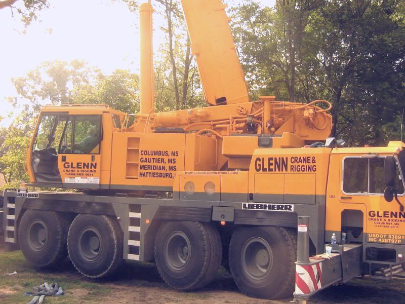

Hey Lumberjack, How's it going? I was glad to see photos of this job again and that big liebherr crane! (what ton rating was that crane again?) I thought it was amazing the way you brushed it out using that pain in the "A" basket? (i know your local regulations make you use it.)
Hiya Mike, going well down here. How's my crane treating ya? ;) That was a 110 tonner, 171' of main boom I believe. The job would have been faster and funner if I could ride the ball :(. It's not much fun being at someone elses mercy as to where you're positioned.
It's their insurance, OSHA doesn't mind, I don't mind, the operator doesn't mind, the manager does. A bit retarded :)
