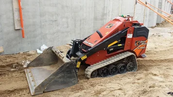

I'm going to chime in here...I have recently demoed the sk850 the ctx100 and the bobcat mt85..
My take aways from all of them..
Ditch witch Sk850..
Pros..strong horsepower, dual hydraulics, bradco adaptor plate was second to none.
Track bogeys were the best..an hour through the sand and nothing to clean out..thumbs up!
Cons...light in the rear... was tippy in sand with my 50" bobcat bucket.
Dual control levers are not responsive enough. ..don't care for them. 32k price..
25k offer on the phone and then we were at 27500-28k during demo....WRONG way!

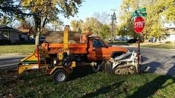

I've been asking around, and haven't received a solid answer. Can a mini handle pushing a 3K chipper around, up and down hill? Into forested areas? Am I crazy for wanting to? I actually think a tracked chipper is close to what I want, but a mini might offer versatility.
I move my 4400 pound chipper with my Boxer 532dx, routinely. The BMG has an insert hitch that accepts slugs. Not as rigid as a dedicated towing set-up, but pretty much does what I want most always. Takes a good operator. I wouldn't expect a newer operator to get all they can out of it, naturally.
I've pulled it up a 25 degree fresh-gravel driveway pretty well, until I lost traction on the loose gravel.
I move it around off-road. A tracked chipper is different, but you will be happy I think to have log, brush, trailer moving capacity. I have moved all my gear to the deep back yard in a trailer in one trip, chipped into the trailer, moved it to the dump spot, and tipped as high as possible (not dumping on its own, but greatly aids unloading). Moved all the wood to the wood shed. 100' fir by myself in a day.
BTW, my chipper has super light tongue-weight (maybe 100 pounds). a strong person can easily flip it onto its butt.
If you're in Olympia, let me know.
I too have a hitch plate for the 25g mini. I can move my 1390 on fairly flat ground. I only use it to move the machine out of the way when the chip truck is in the shop or I need the chipper closer to the garage to do maintenance on it.
I also like it for my rake... but I can now put that under my BMG and soon to be on my root grapple
