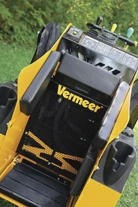

Additionally, dw swallowed the koolaide and put side operator cockpit thigh supports like vermeer has. It seems like a pita, when going backwards.

I am confused about the Koolaide comment. Why would this be a pita when going backwards.

Minis in tree work are more constrained to travel backwards with loads instead of forwards, to keep from snagging brush under the tracks and to keep from dropping logs on the hood. I think you already know or have experience with this.
When I go backwards I stand sideways, look sideways (90° instead of 180°), floor it, stick my butt out off the side for agility and balast, and even dangle a leg on the edge of the foot plate. This straightens my joints to load my ligaments instead of my muscles. I also drag my knee on the pavement for stability in the turns. I'm kidding about that last one - I don't drag my knee. I felt boxed in and knocked forward off balance by the sides on the new vermeer and could not achieve optimal balance/agility. It felt "production-like/'merican/overbuilt", etc. The sides are designed to provide stability while operating facing forwards - maybe 1/5 of my workflow...
Additionally, the sides encourage one to stand straighter, which means I would take all the vibration straight up the spinal column as stacked compression. On the sk650, vibration is a bit exaggerated because the footplate has less antivibration capability than newer minis. Fortunately, there are no side supports so my spinal column is not oriented on the vertical. Without sides, I can do yoga while in transit with my loads, which is important to prevent repetitive task injury. I come home sore after extended periods on the mini. It's work!
That all make sense? Anyone have a different take?

how wide are your hips!? i don't have any trouble with my vermeer side cushions.

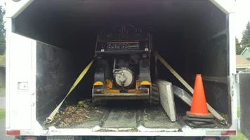

My sk650 just barely does not clear the roofline to go inside... I keep my stump grinding attachment just inside the back and pick it out with the mini.

Minis fit truck beds and chip boxes. Mine goes in my f450 service body bed, and f600 southco box, both under CDL.
Ramps were spendy ~$1200 discountramps.com, but fit both trucks, and bridge over swales.

My mini is 1" shorter than the bed on the chip truck, so I have to load it heavy end down-hill, nose-first. I can grab a log chunk in the grapple if I really want, but don't really need to. I can rest the grapple against the ceiling of the box for stability, but have gotten comfortable over time.
I wouldn't load my mini without an attachment, nose first. I'd chain something to the loader arms for weight.
I can load it properly, heavy end uphill into the 6' box on the service body.
