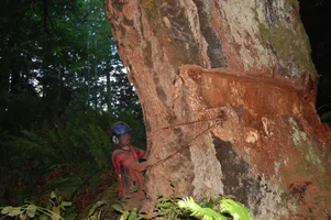

On removals, then the advantages are not as many, depending on how you work the tree. Mainly because you're generally positioned on the trunk the whole time, you can cut off anything thats in the way, and you have spurs. On wide old growth type conifers, if you can set a line from the ground, its gonna be easier than flipline and spurs too. Much less energy and time spent trying to whip your line around stubs and shit. Just a direct route to an easier part of the tree. The pic bellow show one such messy dead fir. Had to access it the old fashioned way. PITA
View attachment 32887 View attachment 32888
That is a big old Doug-fir to be taking down in pieces. Did you have to rig and lower the bole pieces or could you just chunk it down and toss them off? Either way, running a big old saw while chunking off one block after another in a tree that size is no small thing. My arms hurt just thinking about it.
Nothing like that. I was just setting the rigging to fall it down hill. I say just....it actually took a while to set up....what with ground anchorus and MAS. DSC_0099.webp
