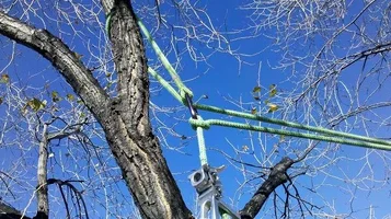

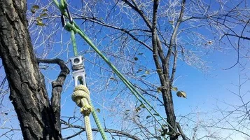

Here is a re-direct idea I use (when it is necessary).
I'll climb both DRT and SRT on the Uni. In the photo, I am climbing DRT until I need to drop down to a different area. I'll then rap down SRT and work off the Uni SRT. I'll then ascend to my re-direct, disconnect, and switch back to DRT.
It is super easy and only requires one biner.

Good questin Kevin. I like to use the DDRT when I'm descending (to save the life of the Uni). If I anticipate alot of ascents and descents (especially longer ascents), I'll be on SRT with the Uni.
I'm still trying to wrap my mind around that one Jamin.
The terminating end of the DDRT is placed through the target crotch and the biner is fixed to the clove hitch that is on the working end of the DDRT.
Notice that the orginal T.I.P. is lower and about 15' away from where the re-direct is. If I didn't use a re-direct, I'd be forced to unnecessarily climb harder to do work below me (and even further to my left).
The SRT re-direct is much easier to work off of than a DDRT re-direct. That is the point of the post...
