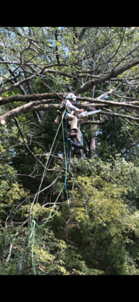

I will use an SRS and MRS in questionable trees or if I need to work a wide canopy. Here’s a situation where 2 systems were necessary. There wasn’t anything above and the tree in a fence row was reaching for the sun. I’ve never used or rented a lift or bucket and the septic tank was below. The angle from the closest tree for a limb walk wasn’t doable in my mind. I thought too much of a risk from a big swing. I put my SRS in primary tree and MRS in a secondary. I then walked both up, reached over and removed 3 limbs. Done! And…No I didn’t head cut, it was 3 smaller ones reaching downward.IMG_4475.png
