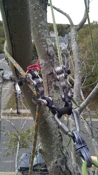

Basically, 3 swivels, but complexly, 3 swivels arranged such that the 2 belay devices in a 2 rope system can operate entirely independently OR together. After working with Paul over in Japan, he replicated my system and then made a video displaying it in detail.
Dang. that is a killer two rope application. Thanks for sharing.
that's a really cool tree. What kind is it?

Both the heli belay and the redirect in Paul Poynters video have me madly inspired. Small break with temps above 0 so did some two rope practice today in an old sugar maple and man - it was a heck of a time. Great exercise in rope management and planning a working path.
That line management is the most important with one rope yea, but two is double the fun!
I do a lot of pre redirects when dsrt. Work off a drop down between unions leaving tail opposite side of a limb, I’m going to move over. Pop the bone off pull tail slack now I’m other side of limb with that line.
If you keep the splice on the tail there is some good tricks to use it for retrievals on a large spread span across the tree , capture that line span before you descended with a carbiner in a span and pull down to reverse off that when done in that area of the tree
Does that make any sense ? Haha
