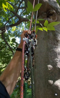

For ultimate freedom of movement, the Helicopter Belay is also the jam IMO. I had a RE Nano on each Bone, going into a Delta Link, going into a bridge swivel. The Delta had a rubber spacer to keep the Nano eyes apart. You could substitute the Delta for a RE Pirate, also with a rubber spacer.
The Camp Gyromania does look the business, but I do believe the Helicopter Belay as I described above ends up more compact as there are 0 crabs involved vs 3. That’s no criticism, both have their ups and downs.

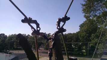

I believe this is what oceans is referring to for the helicopterIMG_20160719_172916368_Original.jpeg
Being a bit out of sorts, and taking multiple days to compose my last post, @Muggs ’ system is as compact as the Helo B, yet the carabiners might tickle alignment of the two Bones, potentially affecting one handed double belay operation? I don’t know. Muggs will have to comment.
One thing I will say about the Helo is the Bones can sit directly beside each other (side by each? Haha). You can easily put your mitt around the two. That was definitely something I didn’t get with other systems.
