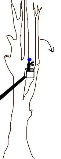

Because of the bucket reach, you need to cut at around 40 feet high at the highest. This leaves almost the same length limb above the cut.
Due to the height of the tree, you have no room to let the limb "run". You are hinging over a very long piece.
so, you want it to pretty much stay put near the notch while it hinges over, then once it settles, you will lower and lay it out with groundmen.
Is this drawing now correct?

I'm certain your drawing is now correct. He wanted advice on how to butt hitch a 40 foot top. But he didn't know what a butt hitch was. Or what rope to use. Or how to tie a bowline. So some of us felt that it wouldn't be appropriate to try to teach all this via typed words on a forum. (I don't know how to add drawings)
