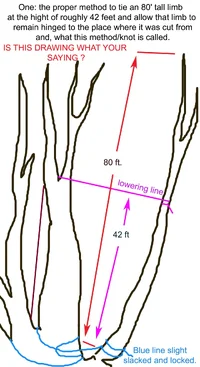

Before I respond, can you look at this drawing and tell me if this is what you are describing?

Mr. Greene, I will try to respond with answers and treat you professionally. I just want to be sure this is what you are doing. IF not tell me how to adjust my drawing. Thanks, I'm going to bed.

Mr. Greene, I try to write after work today. But another question, is there two ropes on the limb? Or is your lowering rope going to be the one locked off trying to keep the butt near the cut/ hinge location?
