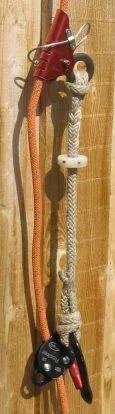

Take a look at the lanyard on this setup. The little disk is a piece of Delrin that I made up. It clamps onto the rope and gives my hand a platform to rest on. This eliminates a lot of the grip that I need to use on the rope. The beauty of this setup is that it's backed up and very compact.

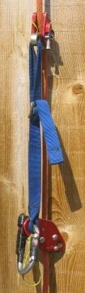

This is my current setup. The buckle on the blue webbing allows me to adjust the length. The buckle becomes the shelf that my hand rests on.

The upper is pushed in the same fashion as a handled ascender or ascending loop. If I get to a point that I climb the tree I grab the rope under the Rocker and pull it up. That tails the slack out and the Rocker grabs. This is the best of both worlds I think.

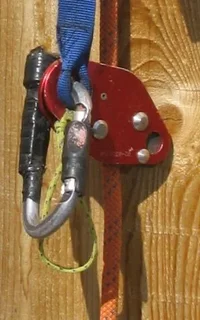

The lower is an ISC Rocker. ISC makes them for Yates. The one that I have is a little different than the one in your attachment. It doesn't have the eye on the long tab. It does have the toothed plate that flips over to lock the Rocker.
The attachment is a pic of the Rocker and the biner with my mods. To keep the biner from flipping and cross loading I added a piece of metal on the side. The metal is the u-shaped slotted metal for hanging shelving. The top tab is padded with a piece of plastic tubing.
