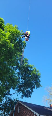

Mick, do you have any access to a rental lift? Looks like good climbing work if inaccessible. Looks like a good lift job if accessible.
Most of my work isn't lift- accessible, so I haven't seriously pursued any kind of lift.
Yeah, I guess.
A lift would have been better.
But he told me it couldn’t be done without a lift…

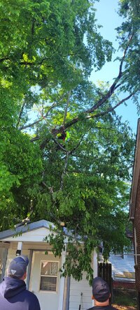

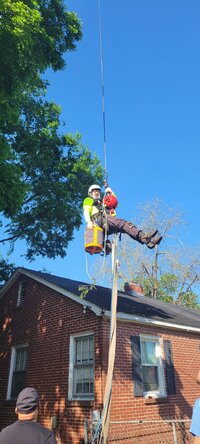

Little building was unhurt. Limb just laid down on it. Other lead o er the house got a bit tricky though. Rope angles were not the best.
