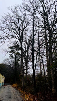

Took 2 todays for this massacre , Had the power cut off for this one, rightfully so , we were well within a few feet of the power lines for this clearing project we had to do. For a couple trees, in fact , most of all significant sized trees were right up on them. I usually can stay 10 feet away and still work safe, but these were too close, and I must say what I nice feeling it is to not stress them being on!! Tag team Avants smoked the ground work ! Even did some team lifts on some larger long logs for fun
Last picture was before we started
last was first guess not sure what happened to the order
