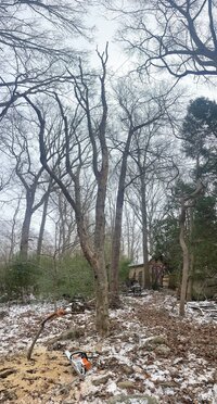

Among a bunch of other things, we hung a very dead woods Red Oak (slender but pretty tall) in a well aligned Span Rig. Just like the good old days! Walked the butt a good 30’ away from the stump and barely squeezed it into the lay. The first pic is a vertical pano…hopefully it displays properly.
