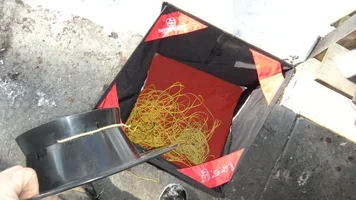

The performance, I am <u>very</u> happy to say, is excellent. 200 feet of line goes on in 29 seconds, casually, winding at a reasonable rate. You can expect and count on, a 50 foot shot (50 up, 50 down =100 feet of line) will require somewhere between 10 to 15 seconds to put back on the reel. You can retrieve the line back onto the reel while walking the reel back to the truck. Although I don't know this for sure, firsthand, I believe a noobie groundguy could be trusted with this and manage this new tool with success from the first time in his hands. It is very straight-forward, intuitive and uncomplicated.
By far the biggest advantage though, is being able to throw or bigshot right off the reel without tangle.
85 feet is my best BigShot, off the reel, so far, though I haven't been going for a record, just regular use at work in setting lines. I 'measure' by virtue of having a 150' rope and the reel has 100 feet of red Zing-It and 100 feet of orange Fling-it, I'm not actually using a measuring tape. I estimate. These aren't highly critical measurements. The 85 foot shot left my 150 foot rope 20 feet short by the time the bitter end left the ground (yes, I went and got a longer rope).

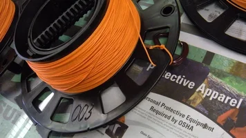

This is Gerry Beranek's reel. Compare it to Pigwot's reel......
See how Pigwot's orange-line reel has a higher lip? On Gerry's pre #1 the lip was cut flush with the inner handle. I have found that a lip about an inch high, like Pigwot's is just perfect.
Remember earlier how I said I didn't like the tapered-drum reel?
Well, I learned it simply needs to be initially wound up differently
than the old vertical drum reel.
On the older vertical-drum reel, you want to wind the reel so you end up with a slanted buildup of line. With the newer reel, you're already starting with a slant.
On the vertical drum reel I would start winding the empty reel by tightly winding on a single, continuous wrap onto the drum, from bottom side, completely to the top side covering all the plastic surface on the drum; THEN start building up the shallow taper profile with line.
On the new reel the line starts building immediately in the V-ist part of the shallow V on the reel. Then the line is applied to the reel and you build the slant form without covering all the plastic on the drum first.
