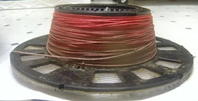

Re: tapered drum reel
This picture shows the tapered drum reel. Imagine a taller lip. The problem with the lip at the height it is now (as shown in the picture below) is that if you fill in the 'v' to get a more vertical drum, by the time the drum windings create that vertical profile, the lip is gone and you risk multi-coils peeling off at once. This is unacceptable bad.
This reel was sourced through a list of phone calls to manufacturers, one passing me on to the next until finally I reached an independent distributor who had posession of several thousand of these reels, all discontinued and sitting in a warehouse. He'd have loved to unload the entire stock on me. He provided me <u>one</u> to work with and that's as far as it went.
