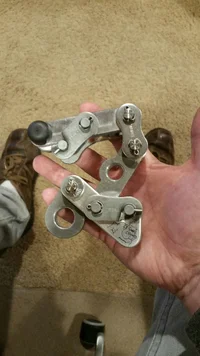

For Christmas I was hoping to add my Akimbo's younger, hotter RE sister to my device haram, but then I met this steam punk kissing cousin and I am digging it!
Don' get me wrong, I am still the Akimbo's biggest fan, and I will get the RE version when it shows up, but in the mean time I need to get a second rope in the tree and the BdB is a rockin' option.

Just for the sake of giving credit where credit is due, the Compact Bulldog Bone is more like a steam punk mother to the Akimbo, rather than a cousin. The Akimbo is derived from modifications that Gordon freely permitted Jaime to make to Gordon's Compact Bulldog Bone, with help and advice from Gordon. Inventors freely borrowing each other's ideas and putting their own twists on them is what is propelling these innovations forward. Folks like Gordon, Paul and Kevin having hearts big enough to allow it, with no concern for ego or greed, are what is changing the way that climbers all over the world operate within the canopy.

I suppose I had a rather backhanded influence on the Akimbo, because as Jamie was making his modification to my OAR idea I asked him not to use the swivel aside chain links in a commercial application, due to my provisional patent for that idea. He then developed the X spine configuration and eccentric bollards.

Couldn't agree more, however you want to define this metaphorically disturbing familial device relationship, there is no denying that Gordon is a continual innovator that contributed much to the Akimbo project, while also continuing to innovate down his own device path with the BdB. I just supported that belief with my hard earned cash, and am following the evolution of the mini closely as well.
Jaime put his own brilliant twists on similar mechanical functions and made a swanky new fork in the device family tree.
