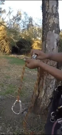

I need to defer to a MRT climber for advice on the cambium savers in the pictures. Personally, I would not use a caribiner in that setup because a permanent ring could achieve the same goal, but - again - not a disaster, and perhaps some strengths.
looks like a rollclip, so integrated pulley into the carabiner. In this case it makes it midline attachable as well
I want to do one with a Big Dan carabiner and a X Ring attached with a sterling hollow block just like that one in those pictures, I want it to be midline attachable.

This is what I use, and it's midline attachable. If you go this route, either girth hitch the carabiner, or use a corner trap
