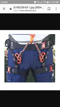

Actually, the BJ saddle does not look like it has a method to replace the rope bridge. This is a major safety issue.
This is a good catch, on your part. Unless a person has the ability to stitch his or her own bridge rope to a life safety standard, you'd have to send the whole saddle back in in order to replace the bridge.

They show sewn eye bridges as an option in the PDF you posted, don't they?
A BJ owner could cut off the worn stitched bridge and tie a new bridge on, terminate with double overhand noose knots. That's how myself and others added a second bridge to the TM, works well.

Thanks moss. I guess I was just seeing that it looked like they stitched the rope bridge around a big, conventional looking ring, instead of passing it through a smaller opening. I was thinking that the stopper knots might be too small, and possibly pull through those bridge rings. I guess I'd need to see the kind of knot you have in mind.
Tim
Tim
How about this?
