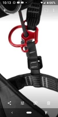

I thought the D's looked interesting, but the rest of the saddle had me wondering.. Since you have one.. what is the purpose of the circled below? It's looks like an adjuster that you can't adjust..
When i had a similar style suspension for a short but with the Ergovation, while I was dialing it in, I kept longing for the ability to make that exact spot longer without touching the other adjustments. But you can't because it's sewn in place. Now i see a saddle of this style design with an adjuster in there, but it looks sewn in place.. why not just sew it without the hardware. The hardware in there seems to have no purpose.. Can u clarify?
Also in this picture below, is what's circled, the means of rise adjustment? Is it just one long loop terminated in the back? No other adjustment other than rear leg straps?

The buckle that you circled is adjustable. The tail is tucked in so that you can't see it.
And the second part you are correct in that it is one moving belt that can be adjusted at the back.
Oh no kidding.. it does move.. could have fooled me.. this pic right here makes it look as if it's sewn in place.. hence the reason for my confusion seeing adjusters in there too..
You see all the stitching there?

It moves all right.
All the adjustabiltity is to complicated for me. I played with it at first and then just left it. It probably isn't adjusted to its optimal settings.
The new ds on the tmevo, instead of just a hole for one there's 2 so you can terminate 2 bridges independently and adjust their lengths. That's if your using stopper knots. They have a different way to terminate a spliced bridge and webbing bridge.
