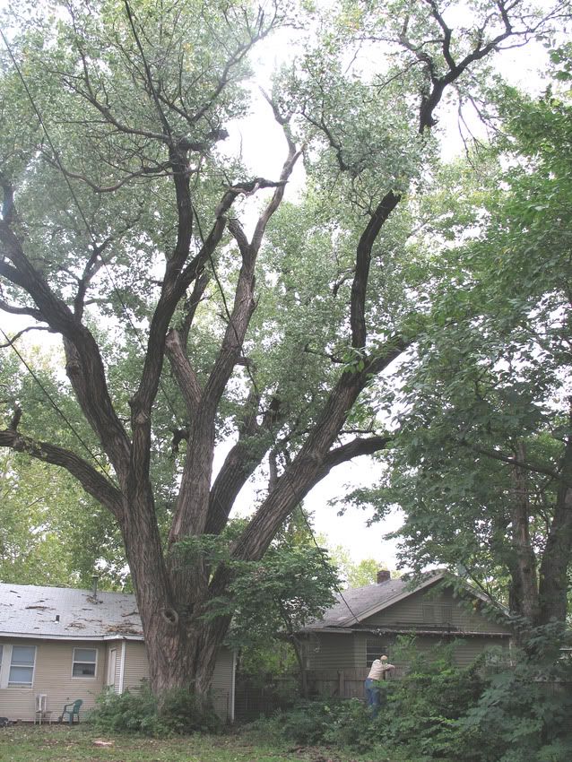

I agree that more information is needed from an in-person, hopefully aerial inspection (unless there are clear red flags from the ground) before any course of action is prescribed to the homeowner. Meanwhile, the discussion continues...
I'm way late on this thread and haven't read all the posts but I'd definitely have the service lines dropped, it would make the rigging a LOT cleaner and easier to set up. Around here they drop service for free with 48 hours notice and get it back up within an hour or so after you call them back.
I've done some that big without a crane but it's such a big production... it's worth hiring a big enough unit to make the reach even if it's just to get the wood out to the trucks.

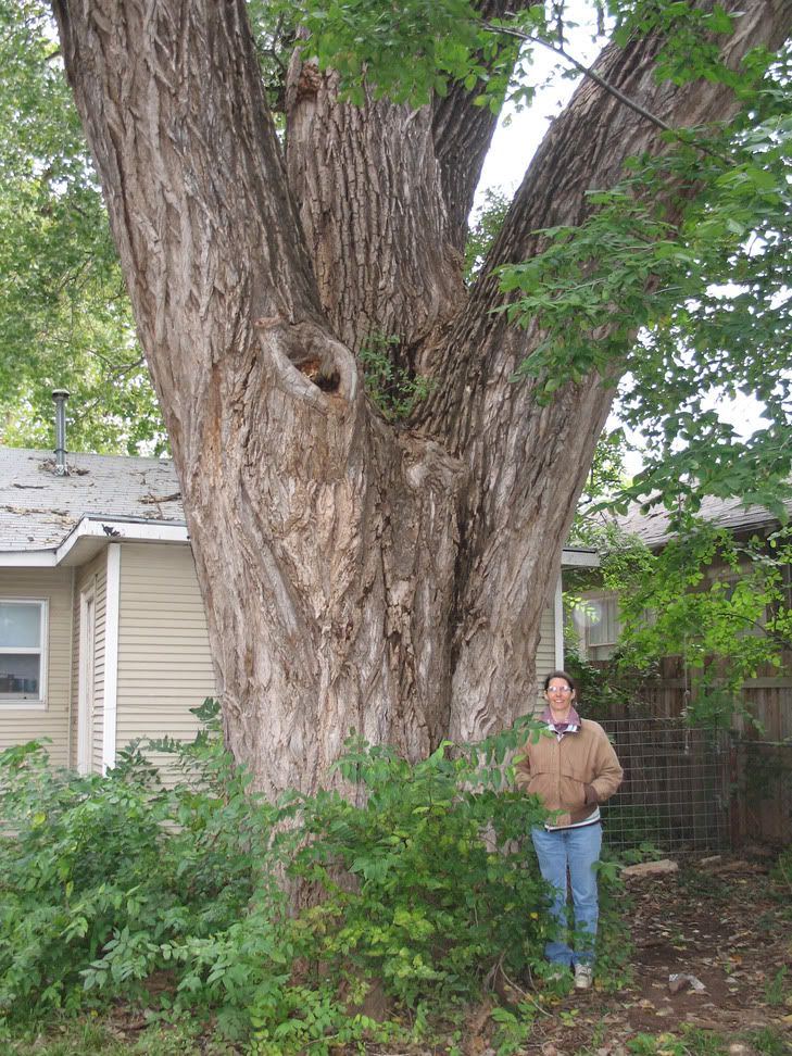

This is hard to evaluate from here "my couch", but I would agree that a large tree of any species does not mean that it is unsafe. There are always options. One that a landlord might like is the prune, cable and monitor option. It would save them money (which I know they would love) and could make them a long term client, and removal might eventually be the solution down the road anyway.
I've been watching you guys make comments on both sides of the arguement, and I've avoided making my own because I haven't had enough risk assessment experience to trust my own opinion, and since I've never seen a cottonwood so that puts me even further in the dark.
But after reading the opinions here mine has stayed the same, if the home owner wanted it saved I would suggest a crown reduction, deadwooding, and cabling, otherwise removal.
However I must say this: If that were my house that tree would be gone long ago, I've seen too many branch and root failures to sleep under a tree of that size and species, which is exactly what half of you guys have been against this thread.
So can I ask you guys if any of you could sleep under the tree in those pictures.
The answer is the same as it is for providing advice.
...size and species alone are NOT the significant elements in terms of assessing the risk of significant harm, since we know a target exists (the house and its occupants) then it comes down to our assessment of the health and structural integrity of the tree and its parts.
...the pictures DO NOT provide the information necessary to form an informed opinion.
If I could see no visible evidence of any structural problems then yes I would definately want to benfit from having such a magnificent modifier of all aspects of environmental and climate extremes over my home.
If I had doubts about the strength of the wood tissues of this species (as opposed to????) then I might install fall arrest cabling....the least preferred option in that regard would be to dramatically reduce photosynthetic capacity in a tree I had concerns over cellular cohesion and cell wall strength!

I believe the arborist profession loses a lot of creditability by insisting trees like this cottonwood can be made safe to sleep under and exhorting the enviromental benefits of having a monster tree over your head and house 24/7. Even people on the street know better, but then most of them are not caught up in tree worship. Don't get me wrong...I do love trees, but people come first.
i believe we lose credibility when blanket statements are made. i think the point we are trying to make is that we don't have enough info to make judgement that the tree needs to be removed. no one insisted it was safe, but that doesnt make it an unreasonable hazard, it needs to be inspected and maintained with due diligence in order for it to be a reasonable hazard. remember that statistically speaking (which is how we arrive at insurance rates) this tree poses far less a hazard then driving your kids around the block for ice cream. if we all went with your judgement the largest and most impressive tree in Calgary would have been long gone. try not to make this a personal assault. im glad you backed up your argument by referring to 'people on the street.' very professional.
The original post "he wants it out of here." Nowhere is he asking for help to save it. Nowhere is he asking to save money. Nowhere does he ask to reduce or even assess the risk. "he wants it out of here" so take it down. End of post.
right, but the thread transformed when someone asked WHY. it is our responsibility as arborists, to provide alternatives to removal when inspection of the tree yields results that suggest the tree is NOT an unreasonable hazard. therefore, it is up to us as arborists to try to educate the public and to preserve trees when the owners of said trees are unaware of the alternatives to removal. but perhaps you are right and a new thread should be started.
i cant tell you how many times, in my brief sales career, that i have been able to sell a prune/brace rather than a removal with only a little education to the customer. there will always be the option of removal, but perhaps in certain cases (maybe not this one) it would be wiser both from a business standpoint and from a tree preservation standpoint to preserve and maintain the tree.
if you want to only do what the customer asks and for you the buck stops there, that is your prerogative, but hopefully you can forgive and perhaps understand why that is just not good enough for me.

"It's in the back yard; you can't miss it". And so it was; 7' across waist high and probably 10' at roof level. He's having trouble getting tennants so he wants it out of here. He says don't worry about grinding the stump just get it down below the roof. How does a cottonwoood seed ever get this big?
Sean I largely agree with everything you've said but in this case.......I think this tree should go. The owner wants the tree out and I understand his concern.
