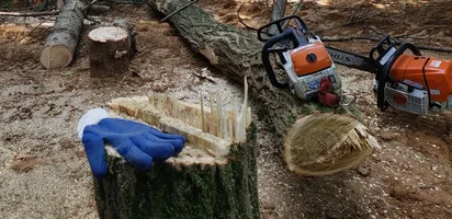

"Nothing is by chance, its all engineered before the cut gets started". Those are your words, so you now have the opportunity to make this a real teaching moment for us all.
1. Reasons for the un-cleaned,unfinished, possibly bypassed undercut. If you look closely you can also see that the undercut has a clear curvature in it. Which plane of the curved undercut is the tree going to follow?
2. Reasons for the utterly destroyed hinge.
3. Reasons for the multi-level back-cut, which upon close inspection, the picture very clearly shows?
Here's the deal on this cut. It was for a client that I liked a lot, who I had done some stump grinding for. He was getting this hill regraded and needed two or three trees down and the stumps ground. The landscaper was in the middle of the job when he called. It was 5 minutes from my house so I stopped by within an hour. I was alone with only the grinder and its pick up.
Locust was a heavy heavy side leaner, leaning up into or close to another tree, big silver maple as I recall.... It had a ton of side lean.. if it laid up into the neighboring tree, it wold have required climbing. I only had the stump grinder and a throw line, no rope..
I needed the tree to follow the notch to get it out past a big silver maple, but then needed hinge to fail to get the tree into an open part of the yard... I found another pic of that posted below. The problem was the side lean.. You would have just had to see the tree to understand.. I really didn't think it was going to work.
And Rico, I'm impressed that you could spot the back cut was made on multi levels from the first pic. i had forgotten all about it and didn't remember until I found the pics from behind...
The other issue is that we only had a throw line, no rope so I couldn't overload the line by pulling with a machine.... Fortunately I got the line set pretty high.... With two or three landscapers pulling by hand I made the initial back cut low, trying to give as much strength to the holding fibers as possible.. You know how much harder it is to pull a tree over with a back cut, below the face. I put the saw down and went out to help pull, but the holding wood was too strong. When the tree didn't budge on the low back cut, I made a second back cut a little higher and little deeper until the tree did move... I was thinking if the hinge held I would need to cut it off and let gravity take it, but the hinge failed on its own, as soon as the tree got past the maple and it fell perfectly on top of the spruce.... Job well done, which again I didn't think was going to be able to make it work , but it did...
I was using the principles of the swing dutchman which Dent describes, so the shape of the hinge is nothing new.. Can't argue that one as Dent is dead... The low back cut, that was all my idea.... I've seen a low back cut on locust give a ton of holding ability on a heavy front leaner, A LOT BIGGER THAN THIS.... So I tried it here, thinking its the only possible chance to get this tree to the lay.. More of an experiment that a practiced and perfected method... But it worked... which surprised me so I took some pictures..
I'm actually glad you brought ti back to my attention because I had forgotten almost everything about this fall..
to your points:
swing dutch locust.webpswing dutch locust reverse clsoe up.webp #1, the face was made with a plate cut which probably had zero effect on the fall, so its more of a habit. The plate cut was not cleaned out perfectly because it didn't need to be... That is not a bypass, its simply a plate cut that is not cleaned out... remember I didn't need the hinge to hold to the face close,... The plate cut itself was probably unnecessary here, but I do it anyhow because its fast and offers the possibility of more holding ability.
#2, trying to get as much holding fiber to fight the sidelean, per Dent's clear description... Apparently he thought it was a good idea often enough to include it in his book
#3 as described above... I've been experimenting with intentionally low back cuts and staggered back cuts etc... This one worked, I got paid 375 for an hours work, the client was impressed with the quick service and ability to get the tree down as planned... and the landscaper was thrilled to be able to finish the job with the trees and stumps out of his way..
This vid at 1:40 shows a heavy front leaning locust that came down really slowly and moved significantly left during the fall... the back cut on the left side was low. This is the tree that got me thinking about the possible benefits of an intentionally low back cut. Just happens to be another locust!
Intentional plate cuts, intentional low backcuts, intentional stepped backcuts, and multiple attempts at the backcuts, because the first one didn’t work? All on this tiny little locust. More changing stories, nonsense, and fucking Hackery.
I would like everyone to take notice as to where this tree fell in relation to the sighting of the undercut. Not even close, so apparently all this experimentational hackery didn’t actually work, even with a tag line.
Why do you continue to post up this shit? The first tree pulled hard to the left because it was a gawd awful cut, stump-pull and all. You did manage to make it hit the lovely mature trees in the background though! Nice work buddy, and yet more proof that you just don’t know what the fuck you are doing.
On the second cut you overshot your backcut so badly, that you damn near miss your undercut all together.
Being a really good faller demands attention to detail, something you are clearly lacking in.
Specific enough for ya?
I’m fucking nutz for sure, but that doesn’t change the fact that Daniel is a con-man selling himself as an expert faller. Time and time again we have video and pictorial evidence to the contrary.
Daniel can make all the bad cut he wants on his own time, but to post them up here over and over, then have the nerve to tell us he is an expert, and somehow better is nonsense. Does this make him a bad guy? Who fucking knows, or cares. I do know I will continue to speak up when I see it.
The tree landed perfectly on top of the spruce in wide open lawn.. that was the lay... that's pretty obvious. How it got there was planned and executed with a notch that was not gunned to the lay. Once the tree was stood up enough to clear the maple I was planning on cutting the hinge if needed, but it failed on its own...
This is not the first tree I have notched one way to get it to clear an obstacle and then had it fall on a diagonal or even sideways to the gun of the hinge. Have you never done that? Is that beyond your ability to comprehend? I have at least two videos showing the exact same method..
