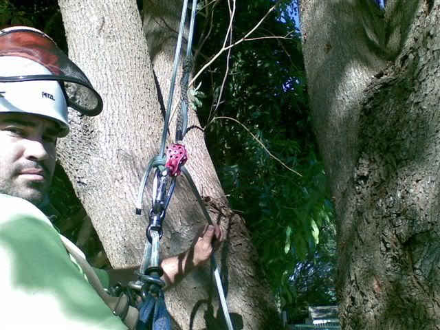

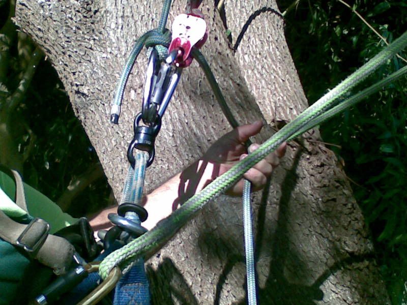

I Have just started climbing on a petzel swivel since i was shown how to us it at a recent workshop by B Strasser
and i would not climb any other way now.
i have a glide harness and i have the swivel straight on the bridge then i connect a biner with a frnch prussic and pulley to the top of the swivel.
i will try and post a pic.
what problems did you have with your set up.

When I used the swivel it let me spin around while I was climbing. The swivel also let my hitch move around so that the 'front of the hitch was over to the side. It is rare that my climbing line gets more than a half twist in it.
A picture of your setup would be great.

I'd like to see pictures of your set up, too, Waratah!

Thanks for posting the pics of the swivel setup. That's very similar to what I used and didn't like.
The problem that I had was when I wanted to brace against my rope to put my hips/shoulders in a particular orientation. The swivel would not allow me to stay in that position and I would have to fight to stay aligned.
One thing that I REALLY like in your setup is that you have your two biners gates opposing. That is something that too many climbers don't consider. I get nervous seeing gates touching each other creating 'gate clash'. Anothe solution is to use a long and short biner, still with opposing gates, so that the biners nest together nicely.
