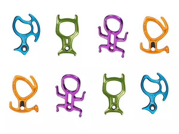

@Epiphyte Thank you for sharing insight from a different domain. Speaking of which, can you tell me why canyoneering style horned descenders do not appear to be used by cavers, or are they? Devices like these.
Rope twist. We often have intermediate anchors on a single vertical section in order to keep out of waterfalls, or away from delicate formations, or to protect our skinny ropes from abrasion on the cave surfaces, so having devices that produce a twist in the rope is a no go.
