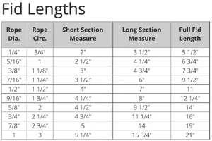

FYI - this is *basically* the same method for all 12 strand class 2 and class 1 ropes. Just need to make sure you are using the proper fid lengths.
Fid Lengths
