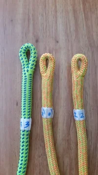

Show off them splices
Success. Not quite as tight as I wanted it but best Christmas present I got all day!

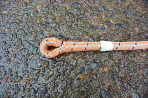

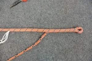

Not sure I am following what you mean by "going through the core"? What I have been doing is running the fid inside the cover, being careful not to snag the core strands. Then I pull the tapered core back through the cover, using a ton of massaging to get it through. Guess I need a picture.
Hope this helps explain it. Do you insert the fid on the left or right side of the core? The Vega instructions seem to show the fid entering on the right side, and it would have to go through the core at the throat to get to the exit point. If the fid enters from the left, it results in the core and cover being buried on opposite sides.
Ok, I see what you are getting at. I am taking them both in on the same side of the core.
So, you insert on the right which requires the fid to go through or around the core exiting the cover. I wonder if that makes it more difficult to do the core bury.
