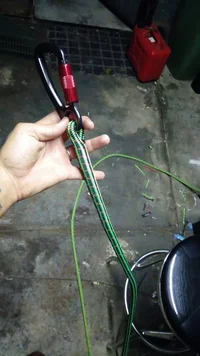

flipline i did for a friend at work, came out well

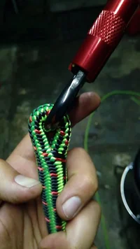

my tie in

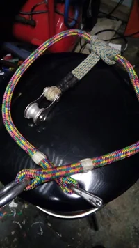

hand ascended to foot loop for another work friend

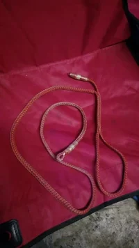

re-whipped my main line, experimenting on location of the whip

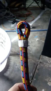

re-spliced a work friends climbing line after he cut the splice off with a 201t, despite being a used rope, managed to get it done

So in regards to the placement of the whipping, if u are not having it broken to see if there's s strength difference, what is it are you trying to figure out by experiment? To see if it's more flexible or something having it closer to throat?
That used Calamine looks like it was a bear to bury.. whenever my splices take a real pronounced hex shape i know my index fingers will be shedding layers the next week..lol. that's a poison ivy line by Sherrill, correct? Surley you weren't getting the whipping next to the throat in that one.. at least not without broken needels! Lol!
Mainly seeing where I can get a good whip in that'll capture the most strands that won't bend every sail needle in my draw, a friend at work has shown me some stuff discussing the necessity of whipping double braid splices. Seems like loose splices like Yale in house splices would be more inclined to needing whipping but tight heavily packed splices it's almost unnecessary due to it constantly being highly compressed even unloaded. I still whip mine but I was mainly seeing where I could capture the most fibres and minimize the abrasion damage to the whip over time.
It was a bit more troublesome getting the final bury to seat in but leaning my 85kg frame into my harness with it clipped on eventually got it home, just took it easy and stretched the splice after every couple mm of progress made. I hadn't seen the whole whipping at the eye thing when I did this, it was relatively easy to whip, about 3" from the eye.
