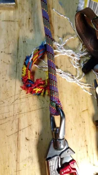

Speaking of addiction, I wasted 2 hours today trying to do another eye splice in Vega. This time I got everything done just right except that when I was done there was a little tiny bit of core strand peeking out of the throat of the splice and no matter how I massaged, milked, beat, and pulled on the damn thing it would not bury. So far I have been unable to get consistent results with Vega eye splices and I am about ready to toss in the towel and just use it for SRS without a spliced eye. I can't trust an eye that is not fully buried.

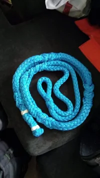

I'm with ya in wasting time though.. i came up with this the other night.. On a gamble I went & snipped a useful length of Ice Tail in half to make it.. turns out i couldn't splice it the way i wanted to (talked about it in earlier posts).. & now i go throw it on the smallest Cordage i plan on using it with & I'm like 1/2in short on length.. just a smidge too short to be useful.. i was shooting for snug but this is too snug.. that & it enlarged too much.. going to try 1/4 hollow braid next.. well see what happens.. Hopefully i can get full buries all the way around.
The only suggestion for the Marlow splice is to try forcing the cover on the eye into the throat. I remember having problems with that to cover the throat opening.
The Marlow splice is fairly long, too long for a hitch cord, if that is what you were planning for the RIT.
I am using the Marlow instructions for splicing Vega (available on their website). I have been following the instructions to the letter except that I have played around with doing the cover taper a little closer to the throat to make the bury easier. If you have never done one of these they are a very different beast. There is no crossover, just the tapered core and cover tails pulled down into the rope over the top of the existing core. It gets tighter than hell in there which makes the buries really difficult. Not a fun splice to do.
Yeah, I have not completely given up on it. Will poke and prod it some more today.
Success. Not quite as tight as I wanted it but best Christmas present I got all day!

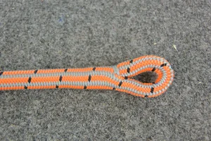

Vega cannot be spliced with a double-braid splice because the construction is more like a kernmantle. It has a braided cover around a core that consists of 8 internal linear strands, each of which is wound from three smaller strands. Thanks for the tip on Gleistein Ropes. And Merry Christmas!
When doing the Vega splice, do you bury the core and cover on the same side, or one on each side of the core? The instructions visibly get confusing from step 7 onward.
First I bury the core and then I bury the cover right on top of the core, both on the same side. But I am not sure if it matters. They could definitely do a better job with their instructions.
