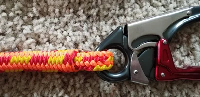

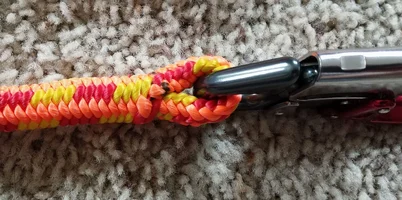

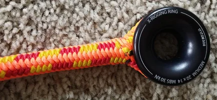

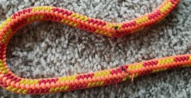

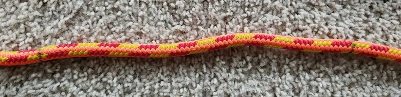

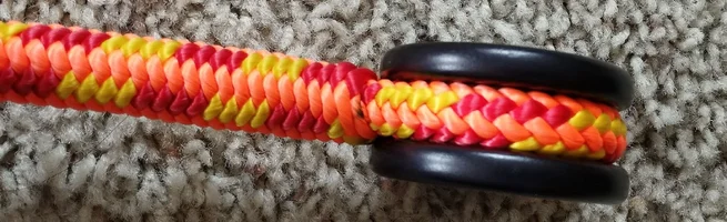

Had about 30' of Yale XTC Fire from a treestuff rope bag, turned it into a lanyard this morning (and yesterday evening and the evening before...) I've only got improvised tools, and had never done 16 strand before, so it was pretty tricky at first... but the second splice went a lot faster than the first. Some good techniques in this video and this thread. I did the side with the ring first (credit to @Tuebor for the ring-on-tail-end-of-lanyard idea), but the tools I used to spread the cover strands to extract the core weren't sufficiently rounded, so I broke some cover strands and kind of made a mess. I found a more rounded thin rod to use on the snap end, so that went better. Still need to lockstitch both ends -- it seems like there's a variety of methods and locations to do this, so I'm doing a bit of research.
Finished product:
Tail end (note the messed up cover fibers in the crossover area):

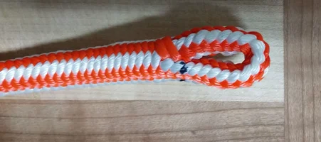

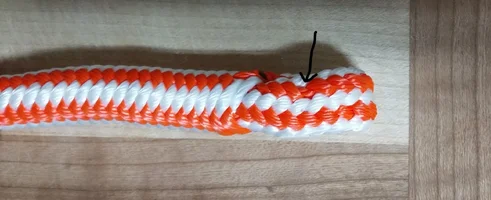

Send help, I might have a problem... third 16-strand splice of the day. 60' piece of Braided Safety Blue Hi-Vee, also from a rope bag -- spliced a tight eye on one end to make a shorty climbing line. I made a better wire fid, and this one was the smoothest of the three, although there's one issue. One of the cover strands (orange strand, halfway up the eye in the second photo) is pulled noticeably tighter than the others, leaving one side of the eye slightly bunched up. How much of a problem is this? I'm planning to go tie it to a tree tomorrow and hang on the eye a bit to see if it equalizes itself before I lockstitch it. Should I be worried about that strand taking a disproportionate amount of the load in the long term?
IMG_20180421_205900.webp IMG_20180421_205912.webp InkedIMG_20180421_205907_LI.webp
For the tight strand, just slide something under it and gently lift it until it matches the rest. The carburetor adjustment screwdriver from Sthil, with edges rounded off, is a good size for this.

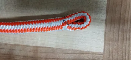

5/8 tenex eye splice. I used waxed poly for the lock stitch and 550 cord for the wiping. I really like the 550 cord.
