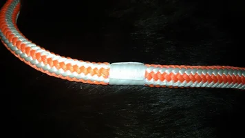

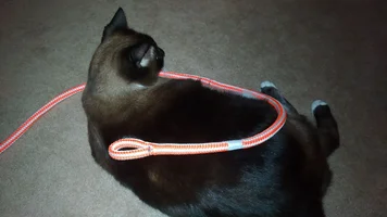

View attachment 41501 Thanks ARLO!
Didn't even have to consult my go to person for them either. Both back to back and no mistakes lol. It's all about the taper prior to burying the core back into the rope. Wish I had carried that over from the Cougar.

You are right but old habits die hard. As an Electrician I would mark conduit all the way around in pencil. This way I could see the mark from any angle. I would erase the mark after if the bend was visible. I know some splicers try and use a marker that more closely matches the rope color but all I have is black sharpies. I think I will try and taping the core exit next and then I can just remove the tape after the bury. All the other marks are burred in the splice. I have some 8mm OP on its way so I will make a few more tools out of that.
Idea - Keep your habits and pick up a fabric marker for sewing at any place that sells sewing supplies. Mark all you want, wipe it off with a damp cloth when you are done.
