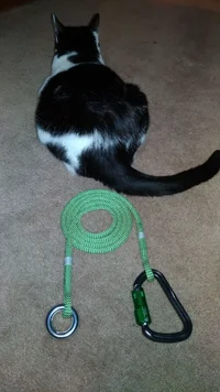

20180301_202251[1].webp 20180301_201201[1].webp i just madre this guy, used it on a small job for my buddy who never used rings or even blocks, all natty crotching and when he felt how smooth the ring was he said "SELL ME THAT!!! I NEED IT! he said its like F@!@$%in without a condom for the first time lol then he asked me to make him a bunch of ring slings and split tails, im starting to see the benefits of this lil hobby! not only have i saved a ton on my own gear but now im making money....to buy more gear...yes i have gear itis, im an addicted fool
