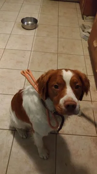

2.2mm zing it eye splice. Someone on here stressed the importance of having a second line and I agree. Here is my spare, ready to go. Now if I could only get Mia to climb up and set the line for me.

She will chase a rope but I have not tried the laser. As much fun as it is to see an animal chase it, I always feel bad when they get confused after it disappears. Now when my dog drops his toy in the sink I just laugh at him because he knows better and he is only trying to get my attention. Actually it is any sink, the dishwasher, washing machine or dryer. He even put it in the trash. My wife will run the dishwasher after he puts his toy in it and he will wait in front of it the whole time.
That splice is fire. You just need an animal in the picture.
oh yea i forgot the kitty, shes been sleepin quietly allday while i spliced/whipped a bunch of stuff ive been putting off.
