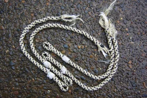

Here is a picture of a couple of Bee Line E2E splices that the folks at Treestuff just broke for me. They did a nice job, emailed me two excellent graphs of the test results, and mailed the ropes back to me so I could inspect the breaks. Both prusiks were tested in a basket configuration. They both broke at approximately 10,400 lbs.
Those are great looking breaks!
You were testing class I splices on a class II rope? Why?

Reed, why do you think they are class I splices? Maybe your last name is Kent, as I' m not seeing anything on the outside!
Because no one would bother to go through the complexity of a Class II splice for an eye to eye just to have them broken. Beeline is spliced with a modded Class II, naked eye.
