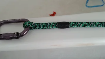

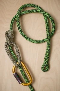

Imori and Arbpro.......
That Imori is really pretty rope... the green is not quite "pastel" but heading toward it, and almost has an iridescent sheen to it.
Hidden lock stitching all around. Have good lighting when splicing these; the dual colored strands make things confusing now and then haha.
Anybody got tips for splicing eye-to-eyes, particularly, getting the right amount of core for the 2nd eye? First attempt I ended up wasting because I had too much core and couldn't get all of it milked back in. On this one, I overcompensated, and ended up slightly shorter than my intended overall length.

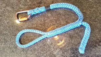

First adjustable foot loop for my knee accender. Im starting to like ttec

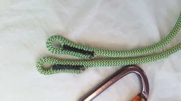

Thanks guys. Been doing it for about 5 months following moss on his hand stitched process. It works really well. This one i just did i use as a secret weapon. It worked well. Its hard to see the threads the glue i cover it with got scraped up.

That's insane, you actually hand stitched those eyes? You are definitely the Man. I really need to know how you actually did them. They look professionally sewn by a machine. What's your secret?

Tenex is one of the funnest and easiest ropes to work with. Did you use a sewing awl to stitch the E2E? Now that I've got Cherry Bomb down to a fine art, I'm going to be trying Yale Poison Ivy with a tight eye. I may need to start making some bedtime (put you to sleep) videos.

Thanks. If you go to documenting my hand sewn eye process under the splice rack. I just followed moss and what he did. They turn out really strong also there's some of my other splices on that discussion
