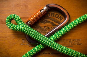

When i did mine I didn't think that it was any harder than tachyon. Just different. A lot of work for a lanyard though
