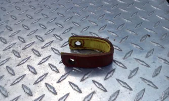

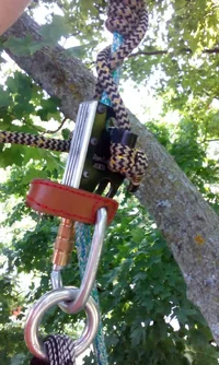

Tryed out my knee ascender and hh2 today,I need to figure out a tending choice cause its nice but hard on the hands compared to the rw imo,any input welcome please
Yea,or even what exactly needs to be pulled up on by the tending strap,i was just keeping one hand under the setup and pushing it up with me.
I sewn up a leather and webbing strap, with a metal insert to keep it U shaped. I like neck loops, so I sewn one onto my shirt, I hardly feel it, a small wiregate connects the two.
