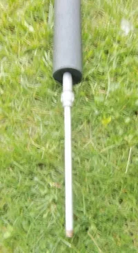

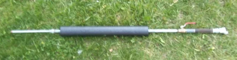

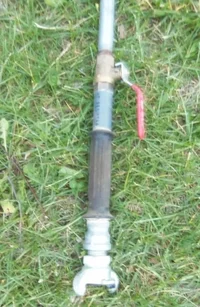

Built it and worked well. Definitely insulated it but was never uncomfortably hot even on bare pipe areas. I think it was 3/4" pipe with a 1/2" bushing that I made several tips for, flat,pointed,open etc. Would still peel bark when getting greedy in clay soil. Ball valve worked fine for regulating air just hard to fine tune while using
Also I built a half inch -> quarter inch version a couple years back but my compressor only has 12 CFM @ 95psu and 100 gallon of tank so no use for tree care! Especially with the heavy clay soils here in the Columbia basin north of 49*
