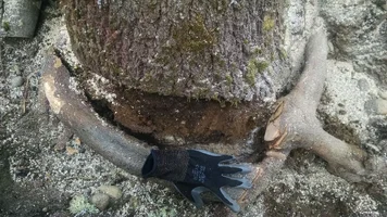

I've done manual, hydraulic (water) and shop air compressor rcx. I am ready to move forward.
