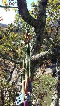

I tried scamming this huge white oak in two different spots.
The first one I skipped over the 3:1 because I planned to work a big section of tree and didn't want to eat up rope coming down to the low limbs. The set up is exactly the same until its time to pull the bight thru and clip it on your bridge. Instead I clipped the rope above and below my system so the tail is pulled to retrieve after taking off the gear.
I did my work and got back to my tail and pulled. Dragging the rope tail thru the canopy and redirect made it twist up real bad so the ground had to help pull hard to get the hockles on the bight to pop thru the biner. Then the biner got jammed in the bight. I couldn't flick it because of rope path so i needed rescue (multiple climbers were in the tree already, so assitanse was immediate).
Retrieval is working best with a direct rope path to the rediect so flicking can help shake the biner loose of the bight.20171026_120425.webp
This was my second scam that day, original set up. See how the twists on the top of the biner have stretched out thru the 1st bight? I think this may cause a "sticky" retrieval or the size of the rock pirate. I had to shake this one loose for a while with some vigorous whipping
Retrieval is working best with a direct rope path to the rediect so flicking can help shake the biner loose of the bight.View attachment 47631

That is a big carabiner to pull through, was it difficult because it was against the branch, or because it just wouldn't slip through the bight at all?
I have noticed the spreading knot occasionally, but it does not seem to affect the function or strength.
A larger carabiner might require a looser bight around the redirect point to give more loop to slip out of.
The bight was pretty tight and close to the supporting branch. I realized after, the looser tied scam is easier to pop out but still secure. Kind of like a floating anchor.
I'm thinking about the quickie now, but the pin sticking out could cause wierdness. I think I have a mighty mouse I could try as well.

You discovered the same thing I did, I did some testing to see if the SCAM could be adjusted tighter, to allow the climber to decide how much of the load remained on the tip, or to direct some of the force down the redirect branch in a more natural way, kind of a zen/ use the force idea, but I found that if it was too tight the loop got smaller and the carabiner took some shaking to pop through.
