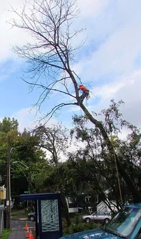

I think I would have worked that removal without spikes, and taken the limbs at half the size, allowing easier manipulation from the ground-man in what appears to be a slightly small area to work the limbs at near full size. It looks like you made more than 1 cut per lower limb anyway...accessing the midpoint of those limbs didn't look challenging based on the photos, and that one-handed operation looked needless and risky to me.
You know what pisses me off about the buzz is experienced sensitive men that act like fraternity brothers, this really creeps me out. A man posts some photos and ask people what they think and when called out for some shoddy looking work, the 40 yr experience and all that rears it's ugly head. I have seen a few stars pitched and let me say this, number of years working at a particular job ( now LISTEN carefully ) does not ALWAYS equate to proficiency. I was going to let this post slide but I hate to see rubbish thrown around. Some folks are just naturals at what they do and learn faster, it happens in sports and the workplace everyday. I personally don't support setting bad examples for people to follow. This post can't affect me but we must consider other's that it MAY AFFECT.

Aweful.
One handed use like this should not happen.
And you all know I don't care what others say, I say it like I see it and I agree, these are bad pictures.
What a shame.
This is why one handed use gets such a bad name.

that limb popped! and was even spider legged with a crane. You could get it in the face if you were close enough to have body close enough for two hands on the saw.
I'm just gonna add this to the thread as food for thought, and by doing so, it exposes that I used to employ 1 hand operation in the past. I am guilty, however, as my skills improved over the years, I now use 2 hands 100% of the time. Can anyone agree that two handed operation allows not only more control and proper engagement of the brake if needed, but greatly increased sensitivity to how the saw is acting in the kerf (i.e.; binding, or tip location on the far side, etc...)
