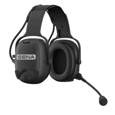

We started using Sena Cast. All mesh technology. No limit on users. Complete setup including earmuffs and helmet attach or over the head. They work good and are comfortable. They’re not super durable. Noise cancel is about the same as other Senas. Maybe a little improvement. Has a mic off button which is nice. The connecting is the nicest part. Just turn on and click a button. Plus you can listen to music while talking which is nice for pruning days. They’re a bit salty tho…
The Sena Expand Mesh is what we run... you can push and hold the Mesh "M" button for ~1 second to mute/unmute the mic.
Double pressing the M lets you pick what channel you're on with volume up/down, then press M again to select that channel.
