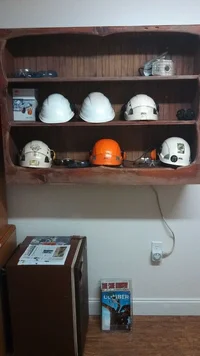

I just put this charging station together and it works great. We put our hats on it after work and plug them in to the power strip. The timer kicks in at 4:30am giving us a full charge at 7am when we get there. I have two of the original units and one 10r (soon to be two), as well as the head set for a crane operator and they all get a full zap. No more charging in the truck. Everything is ready to go and lasts all day.
